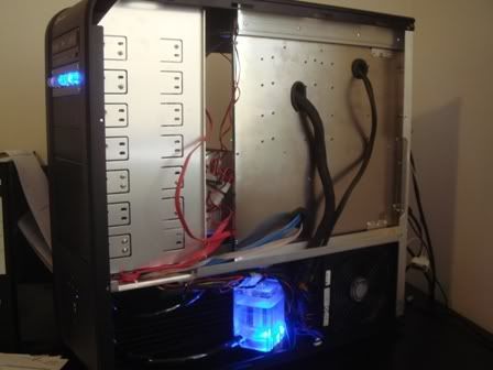

all you have to do is place the motherboard in the case, mark off where your cables will be, and offset them 1/2" to the inside of the motherboard so you can run them underneath the motherboard and out of sight, then cut with a dremel :)
This is what i did with my TJ-06 with a dremel:
http://img181.imageshack.us/img181/1...0016dv7.th.jpg
http://img249.imageshack.us/img249/8...0014hu4.th.jpg

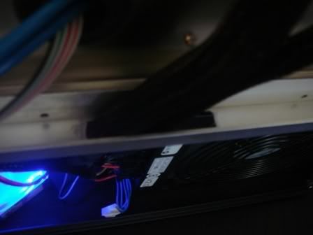

The backside you dont see, lol:
http://img245.imageshack.us/img245/7...0017uy5.th.jpg
