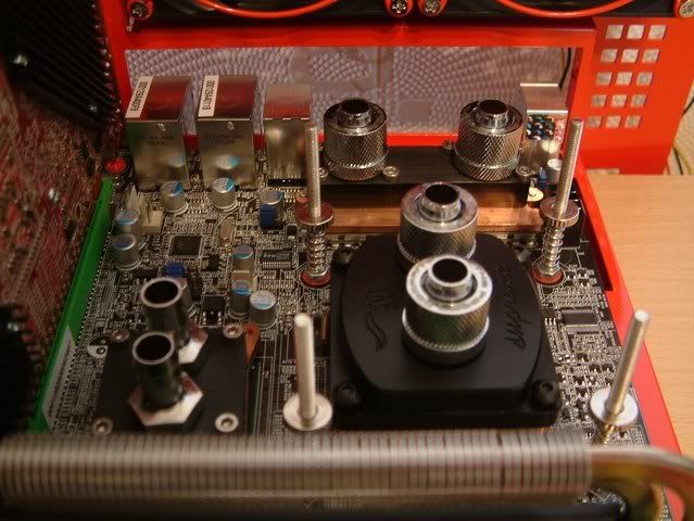

Here is my LT X38 (layout identical to the X48):
http://home.arcor.de/partywg2/temp/CIMG1061.JPG
Ignore the CPU cooler, my phase unit was down when the picture was taken...
