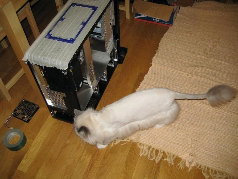

Getting ready to cut. Burnt out one Dremel here. :(
http://img.photobucket.com/albums/v4...0/IMG_0317.jpg

Lion-cut Cali the cat inspects the work area
http://img.photobucket.com/albums/v4...0/IMG_0321.jpg

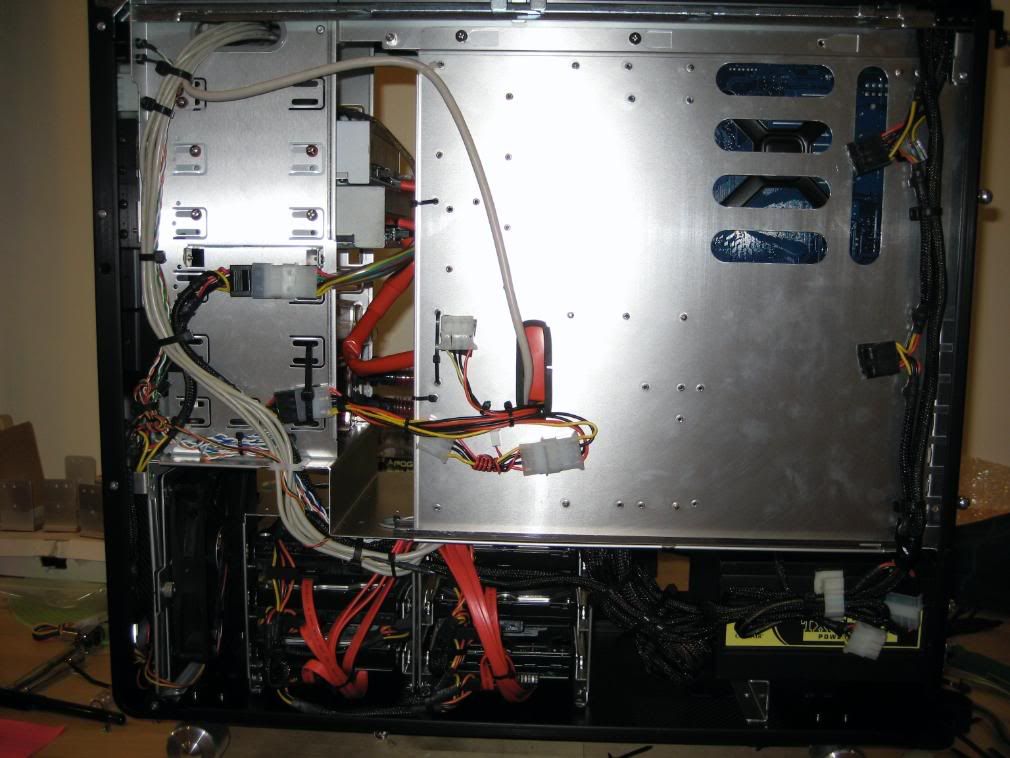

Here is the routing behind the mobo. You have to cut some extra space for the cable since the panel guides get in the way.
http://img.photobucket.com/albums/v4...0/IMG_0328.jpg
It is a tight fit (heh), but I ran two cables through here.

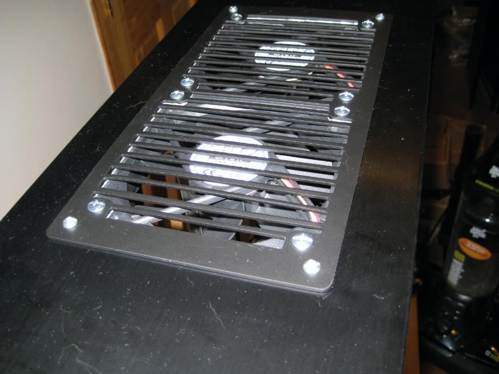

The finished blow holes. Not my best job, but pretty precise, and no errors (an exception for me)
http://img.photobucket.com/albums/v4...0/IMG_0331.jpg
