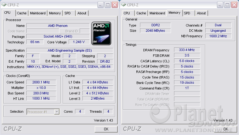

Let us take the example of our practice Phenom 9700 ES. This comes with a clock rate of 2.4 GHz and a multiplier of 12. The speeds are as follows:
1st 200 MHz reference clock
2nd Processor clock = 200 * 12 = 2,400 MHz
3rd Northbridge stroke = 200 * 10 = 2,000 MHz
4th HT link to 2,600 MHz
5th DDR2 memory clock-400 to DDR2-1066
The Northbridge stroke are calculated from 200 MHz reference clock with multi 10th The HT-Link is also available via multi between 1 and 13 * 200 calculated.

Viewed with CPU-Z, the whole thing looks like this:
http://www.planet3dnow.de/photoplog/file.php?n=1410&w=o
