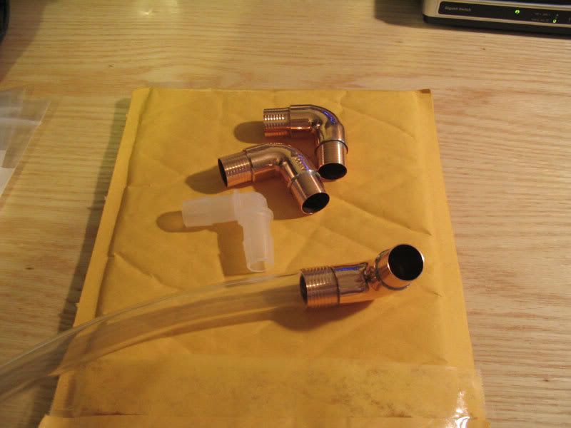

Mother of all elbows...:)
With my mill being down, I decided to finally put my lathe to doing a little work.
http://www.overclock.net/gallery/dat...edium/MOAE.jpg
You may recall the old pressure drop testing I did way back and found the copper elbow being about 1/9th as restrictive as a standard nylon elbow.
Only problem was the worry that the tubing might slip off. Well I fixed that with 7 sharp barbs...:D
http://www.overclock.net/gallery/dat...rioPDcurve.jpg
I'm going to make a few while I wait for my mill repair parts...

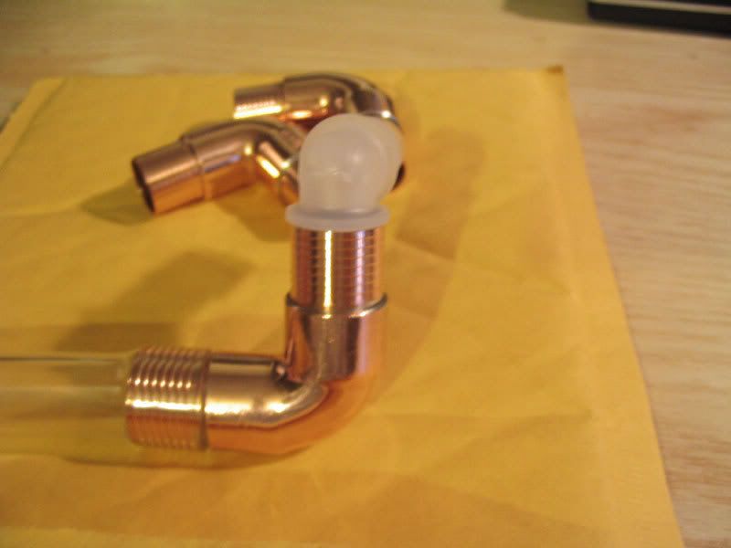

Updated Pics:
Elbows and Tees:
http://img108.imageshack.us/img108/8238/moat1sm6.jpg
Note that these are OVERSIZED, actually more like a 5/8" fitting made from 1/2" copper materials.

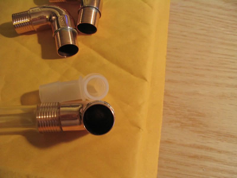

http://www.overclock.net/gallery/dat...dium/MOAE5.jpg
This oversized barb requires prestreatching with plyers or other means:
http://www.overclock.net/gallery/dat...dium/MOAE4.jpg
Example of 7/16"ID x 5/8" OD Masterkleer on the 5/8" fittings:
http://www.overclock.net/gallery/dat...dium/MOAE2.jpg
