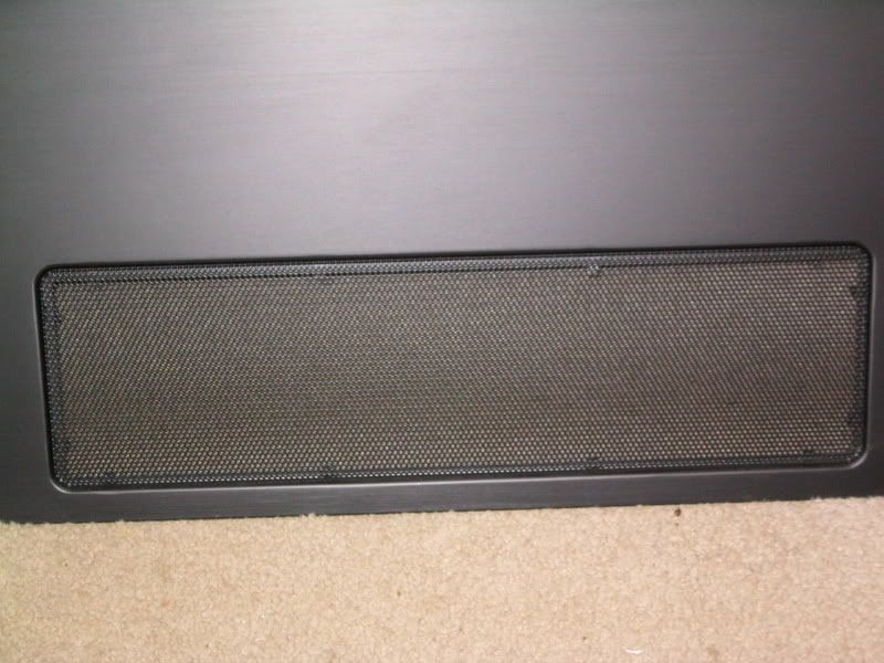

Changed the grills on my TJ07
I've been kicking around changing out my stock grills on my TJ. They're pretty restrictive and raise my temps 3c-5c when I put the sides on.
Most of you have seen my rig already but this is what I started with...
http://i5.photobucket.com/albums/y18...4-21-07043.jpg
Stock grill
http://i5.photobucket.com/albums/y18...4-28-07003.jpg

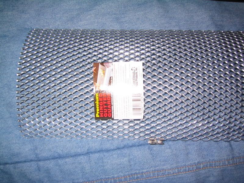

Picked me up some specially made New and Improved Mesh from Home Depot
http://i5.photobucket.com/albums/y18...4-28-07005.jpg

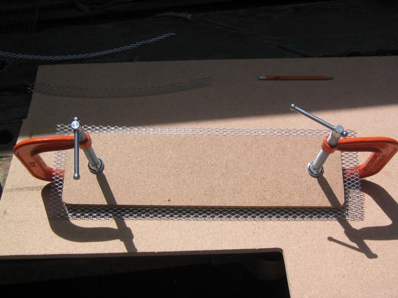

Made some templates of the opening on the side of my case and clamped the mesh between them
http://i5.photobucket.com/albums/y18...4-28-07007.jpg

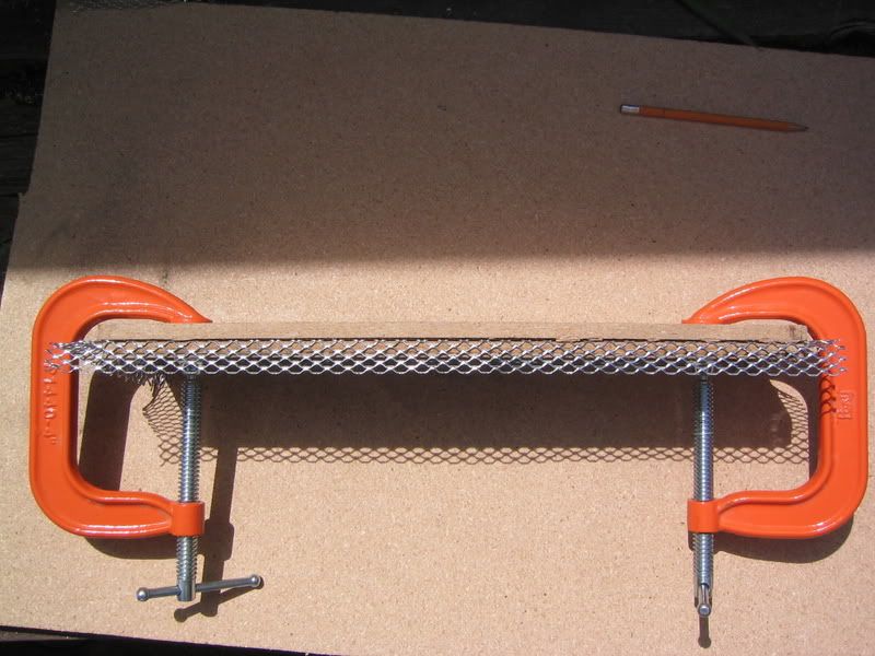

Slowly work my way around bending the sides down
http://i5.photobucket.com/albums/y18...4-28-07008.jpg

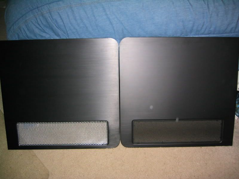

Side by side comparison of the finished product
http://i5.photobucket.com/albums/y18...4-28-07009.jpg

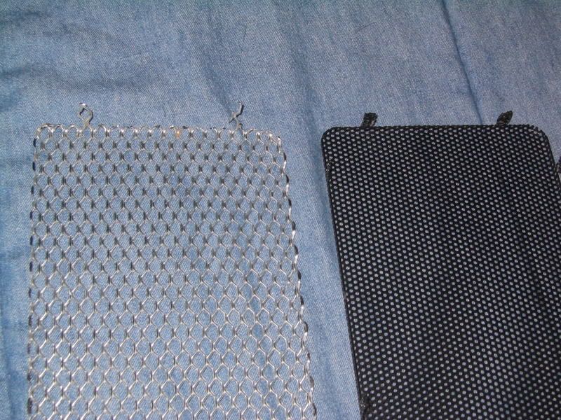

Mounted
http://i5.photobucket.com/albums/y18...4-28-07002.jpg
Another comparison
http://i5.photobucket.com/albums/y18...4-28-07001.jpg

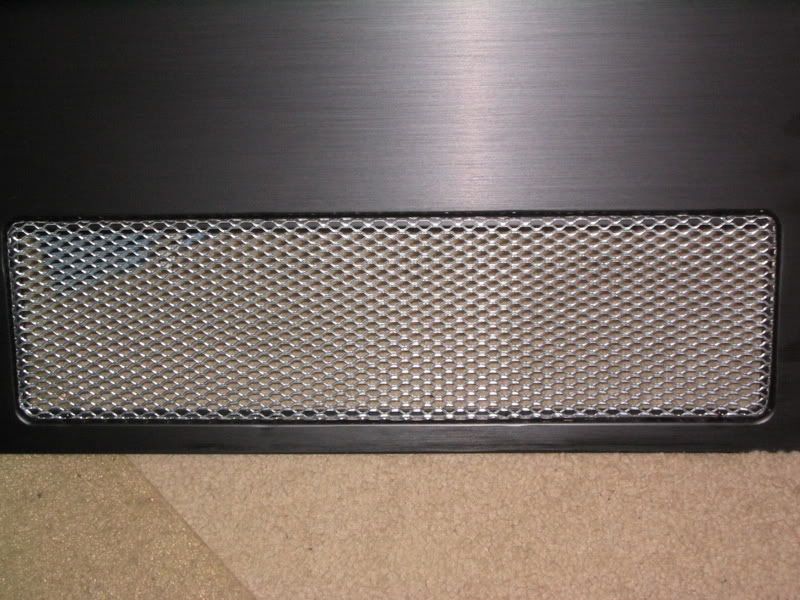

And on the case
http://i5.photobucket.com/albums/y18...4-28-07014.jpg
So, temps now stay the same whether the side is on or not. :D Now I'm undecided whether I should leave it silver or paint it black? I kinda like the contrast of the silver but I'm sure it would look great black too. What do you guys think?
