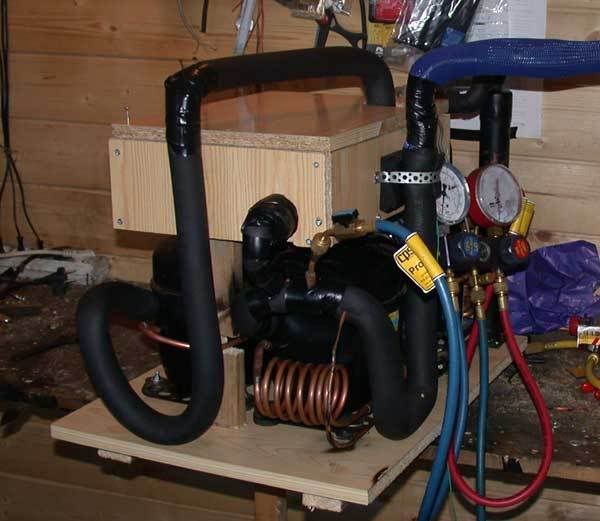

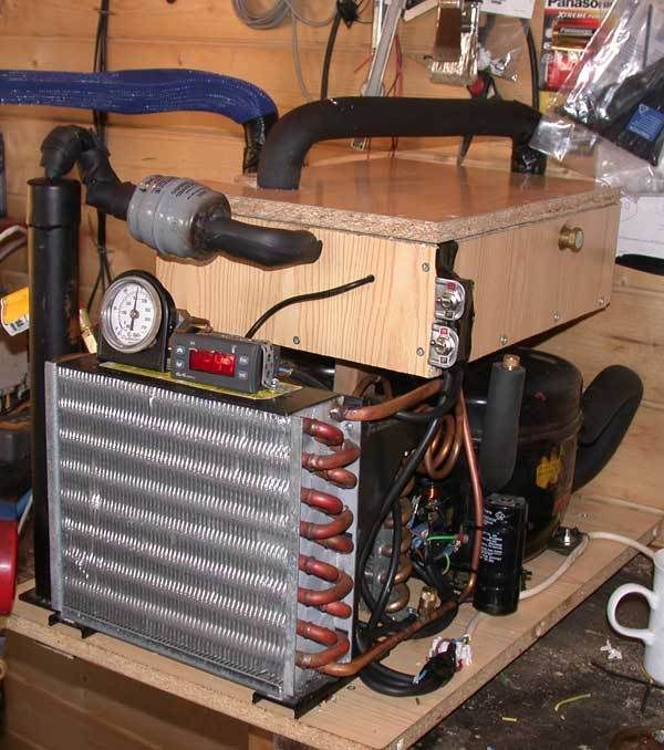

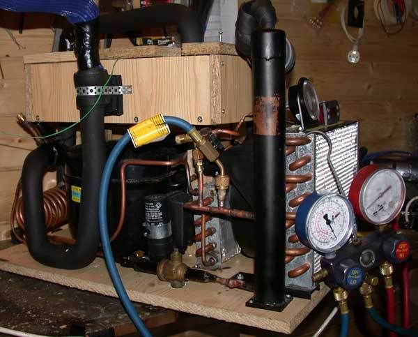

In this tread i wil post all my cascade buildt and this is my latest little baby.
After i saw that Ricky started on a smal cascade with fr 8,5 an stage 2 i deside too test the same :)
http://i23.photobucket.com/albums/b3...on-cascade.jpg
Stage 1:
FR 11g
2m 1/2" with 2x 3/16" iside as HX
CPEV as metring device
R402a
Stage 2:
Fr 8,5G
Home made oilsep
Cheff nr1 spiral evap
Smal condenser as desuperheater
2,3meter 0,31" cap tube
R1150
http://i23.photobucket.com/albums/b3...okk/hx-box.jpg
http://i23.photobucket.com/albums/b3.../left-side.jpg
http://i23.photobucket.com/albums/b3.../back-side.jpg
http://i23.photobucket.com/albums/b3...p-pressure.jpg
I started it upp and temp out of stage 1 is -47c and evap temp is -99c :)
Slap here on a X6800 @ 4700 1,78v and run some 01 in loop. The temp on evap loaded was -90 idle and about -85c loaded :)
But thid little fr 8,5 is strugling too get the sustion pressure down.... under load it was about + 0,5 bar and the high side was +14 bar ......
Wil try too switsh tge fr 8,5 for a fr 10 and se if it can be better :)
