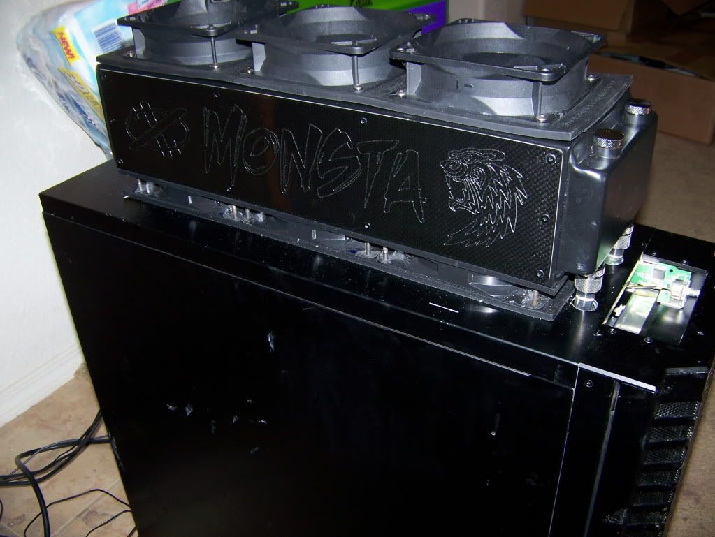

    Quote Originally Posted by Fragger View Post
    It dosent make any "sense" to buy monsta rads either yet people cant buy them fast enough, go figure.
    I agree, it doesn't make any "sense" and certainly doesn't earn any kudos around this post apparently, won't stop me from buying another couple Monstas and .... well, no probably not the fans. But still, I worked hard for half a year and I have every right to flush my money away however I please.
    Agenda: I have 0 projects prioritized for the year, 0 in progress this month, 0 this week, and 0 as of this moment.
    Current primary function: traveling.
    DONT THINK people are buying them fast enough I mean what 250 are made or was it 500 frozen has like 100 of them. I have one and I do like it not bad, but gianed only 1C diff between the quad 480 vs the monsta im assuming though the monsta has great heat dissipation, thats assume.

    Exactly! I currently have ducts going from AC unit to server/computer closet then hot air pulled directly into the attic... and the mini-fridge next to my desk has it's share of beverages of choice.
    Last, as always thank you martin for your diligent research and focused effort. I eagerly await further reading!
    That's enough of my "hot air" for now...

    Quote Originally Posted by xaxis View Post
    Don't be shy, I own 3 Feser XChanger 360s and now 3 Monstas! Was it the best bang for my buck? Most likely not, . In reference to the Monstas, when implemented into my current and ever changing build they most definitely will be absurd! That's okay, I like absurd things, even if they are not a very good idea (see Darwin awards... ). My point is I like Feser radiators and at the end of the day, even if someone else has all the right reasons to despise them, it's good that we at least have so many choices and individuals will always have preferences (this comes as just a thought, not arguing that anyone has suggested the opposite).
    HEY I AGREE even with bad customer service on fesers part I still like their radiators two quads and one monsta they perform great like you said not the best bang for the bunk though on monsta but its cool to see a hyooge rad on the outside of the case.
