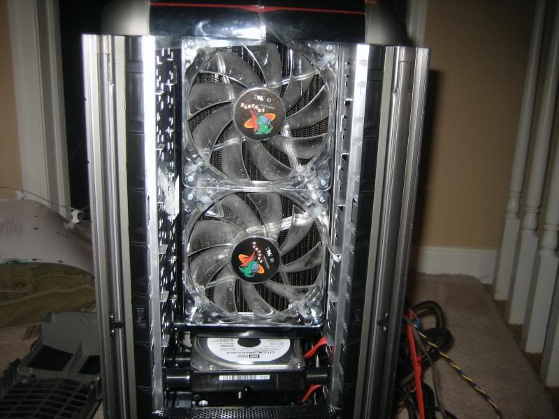

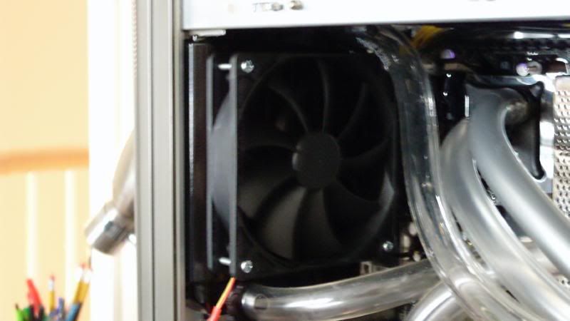

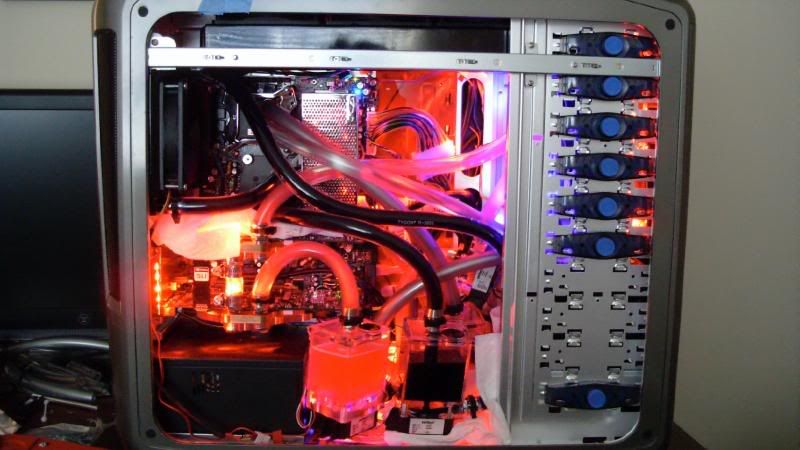

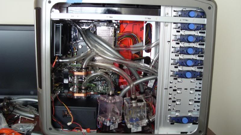

    I installed three loops in my Cosmos S got a BIXIII up top for the GPUs, got a GTS240 in the front and a GTS 120 in the back they all fit pretty well. the BIXIII fits awesomely up top and works very well. here are a few pics:
    Well hope all this helps if you need anything else let me know

    omaryunus - I see you went for the red and black colour scheme. When I saw the red stripe on the black Cosmos case I just knew that it would have to be the same colour scheme for me.

    I love the orange and the black coolant together
