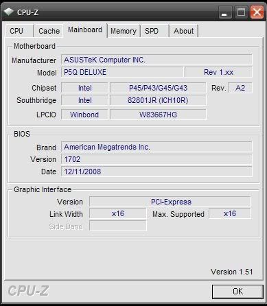

    evening all! No to sound like putz, bur can anyone mod me the 1702 bios for the P5Q3 deluxe. I really would like to get the stability and Vcore voltages you all are getting. If it isn't possible, no worries, Thanks. If u need the file pm me. Here is the link to the asus site.
    http://support.asus.com/download/dow...Language=en-us
    Aug 2009
    USA
    48
    Quote Originally Posted by fishpro619 View Post
    This is the modded P5Q3 Deluxe 2105
    http://www.multiupload.com/N7M2XPOROP
    I mod it with P43TDP PRO Memory Table 0501, INTEL RAID ROM 8.9.1.1002, MARVELL L72, and Alienware SLIC 2.1.
    Since your has the same CPU id as P5Q Premium. There is no upper better CPUID for you. So I didn't change it and I think this is the reason that Ket didn't do it.
    In my exprience with P5Q3, it doesn't support G.Skill DDR3 1600 memory to work even with DDR3 1333. After putting in P43TDP PRO Memory Table, it can work on DDR3 1600.
    So you should be able to get a better memory clocking and compatible. But I doubt you will get a better CPU voltage.
    The others are component upgrades.
    Please test it and tell me how you like it.
